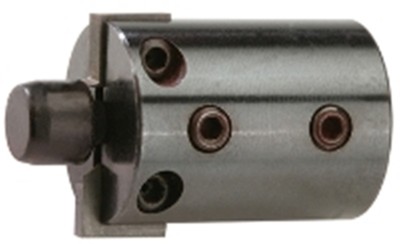

I bought the Giruard cutter only, not their entire setup. I use a Harbor Freight electric motor and attachment doohickey to connect the cutter head to the motor. Works like a charm, just need to count up how many cutter head tools I should order. LOL
I have a Giruard system with various caliber conversions. Once you do the caliber conversions a few times, it becomes easier and faster to change over for all your calibers
Forster 3-in-1 trimmer head with the Forster trimmer. You can unscrew the manual handle and hook up a cordless screwdriver or drill and do all three operations at once and they come out perfect. I found mine used on eBay for $100. It is caliber specific. The trimmer head is interchangeable for caliber.
