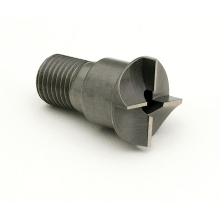

Blurry pics, but it sure looks & sounds like your cutter is dull. I wonder if this will fit your trimmer? Surprised the big red H doesn't make carbide replacements.
