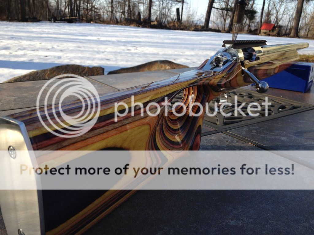

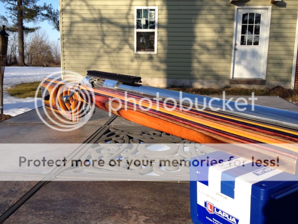

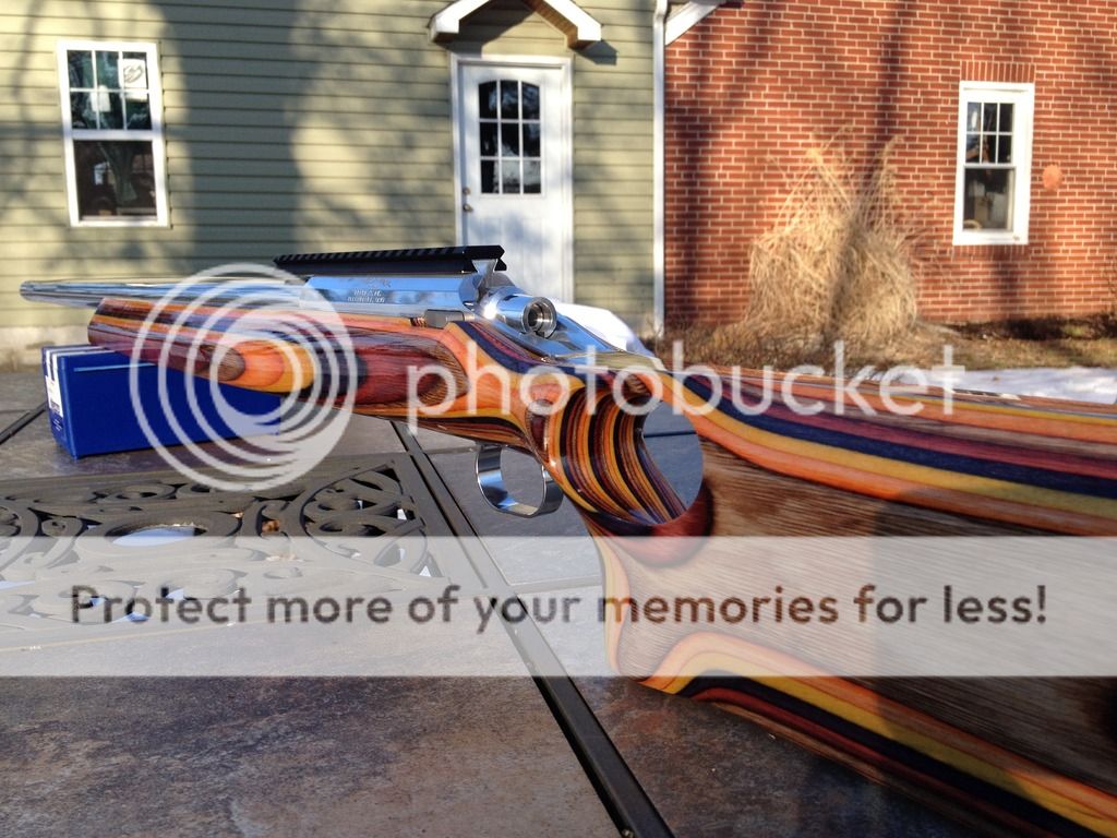

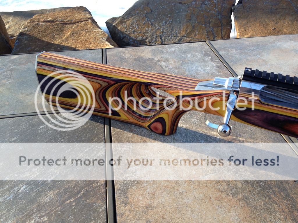

Phil--- Heres a few with that Eastwood European Clear, probably 8 coats. or more on them.....

Fourth picture down, who`s stock is that????
The manufacturer, that is....Not the individual owner.
Phil.
It belongs to P1Zombie killer, aka Wes, I made it for him a few years ago out of a panel of Royal Jacaranda laminate.... One of many of my AXE job's !!!!!!
Heres one that JRS did and asked me to post some pics since its at my shop for a re barrel..... You'd have to ask him what he put on it but its very nice.
Danke Keith 8)
3 coats of PPG Ceramic clear, applied with an IWATA Custom TH dual action airbrush. The airbrush gives me much better control with minimal overspray.
