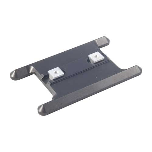

What is your opinion on track plates? Does attaching a track plate to a PRS-stock helps a lot in tracking on the rest like SEB-mini?
I passed temporarily on new stock and looking for an interim solution.
It can help but we would know how to suggest which one if you gave us details on your stock.
Does it have M-Lok attachment capability, Anschutz rail, pic rail, other?
BTW, both you have as examples above are not available. The Whidden shows discontinued and the XLR version shows sold out.
Here are a couple more possibilities:
Some time ago, I purchased both the Whidden tracking plate and the Sinclair/Brownells BR adapter. I modified the Whidden plate by drilling/tapping a couple extra screw holes and adding two QD throw lever clamps to make it easy to put on/ take off of a picatinny rail. Both work in that they do exactly what they're supposed to do and allow a rifle with a stock that has a foregrip that was not really designed for use in a front rest to track appropriately.
Are they just as stable and do they work just as well as a stock that was designed for use in a front rest? I'm going to say probably not. It's close, and they both certainly do the job. However, because of the way they are attached to the rifle stock and their dimensions (i.e. depth of the sides), they really can't be expected to provide the exact same stability one can expect from a rifle stock with deep flat sides that was purpose-designed to ride in a front rest.
I cannot speak to the function of the Kaizen tracking plate because I have never used one. It looks to be a much different animal than the two tracking plates I have and should work very well as long as it is solidly attached to the forgrip.
Generally I would not want anything to raise my center of gravity. If you use something
low profile and wide enough for the rest it could work well and keep your rifle as low as possible
in the front rest.
