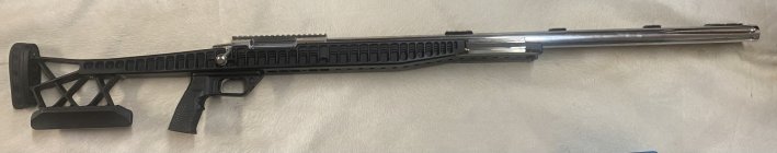

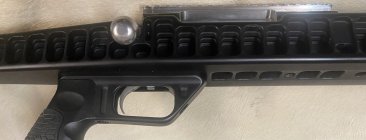

I have this Eliseo R1 tube chassis 6BR that I converted to shoot F-Open 300 & 600 yd mid range. Very low center of gravity. This dude hammers! Have to disconnect the butt stock to remove the bolt. But it takes mere seconds.
