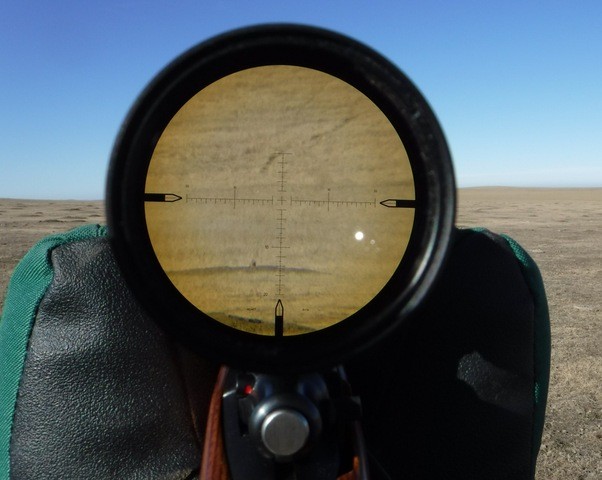

They put the very fine MOAR-T only in the SFP models.
Crappy photo but this will give you the idea. And I ax you, would you want to be putting a thicker reticle on the dog on this mound?
If extreme precision is not the name of the game I'd just as soon go for a hike or something. Trying to be precise with a fat FFP reticle is a pain, esp. since I couldn't care less whether my reticle is *always* synched to my turrets or not.

Yeah, I think I could get along pretty good with that reticle. And I think I'm with you in that I I really like splitting hairs with a fine reticle, but I can't knock the FFP retucles since I haven't tried them, and if I was doing tactical work, a FFP Christmas tree reticle would surely be the ticket.
