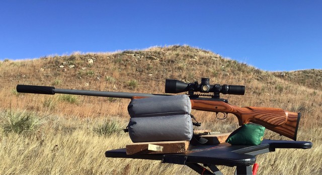

For critters, make mine a 5-25 ATACR with an MOAR-T reticle. For targets I might prefer a 7-35 or a 15-55 Comp, but you want one that does it all. My 5-25 ATACR, on a 204:
I tried the Leupold VX3-LRP 6.5-20 with the CCH reticle in the FFP. Love it for prairie dog shooting. The hold over lines and dots are close enough you don't have to guess. It was awesome not having to dial. If I missed at long range it was easy to correct and shoot again using the reticle. The CCH reticle is perfect. This scope is discontinued but you can still get this reticle in the Mark5HD. I also have sightrons with the moa-2 reticle that work very well for close work but not having the christmas tree windage marks kinda sucks at longer ranges when holding off for wind without reference points. I have sold all my fine crosshair scopes I previously used for prairie dog shooting.
