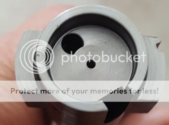

Here are the images I tried to upload earlier today. This is a magnum boltface I bushed last month and a cartridge fired from it.
