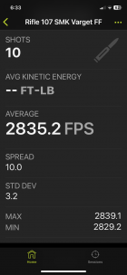

I fire formed some new Lapua brass today for 6BRA while practicing some sling prone work using 107 SMK 0.015” off touch, 30.1 Varget and 450 primers. Nice sharp shoulders formed.
Can’t complain about the accuracy or the SD /ES during fire forming. Shoot it in a match while fireforming. Shot two came down two clicks and had a good X count clean string. Ended up 499/500 for the day with the 9 going right where I pointed it.
