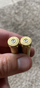

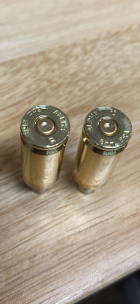

I’m having almost the exact same trouble. I’m having a very heavy bolt lift with new alpha brass in a variety of powder charges from slow 2800-2950fps. I’ve tried different powders. Brass shows ejector marks and shaving some off when opening bolt.
My situation is a new barrel (less than 50rds).
I’ve tried sizing the brass and trimmed like shoot4fun mentioned.
My next guess and step is to fireform some Lapua cases and see what the results are.

I did try a sample thru the FL die. It made no difference at the case head and the brass was already short of my fired brass by .004. I did use a mandrel on the necks, trimmed, chamfered and deburred.
I’m right there with you shoot4fun. I’m glad yours was any easy fix with trimming cases. I noticed my alpha cases were longer around 1.556 vs 1.550 Lapua. So I trimmed to 1.550 just to rule that out.
SPJ, I sized 2 groups of 5 cases each with two different bra dies. Still had heavy bolt lift.
Solution in the chamber was mentioned above and I’ve thought about this being an issue. I’ve cleaned a lot during break in. I’m wondering if there is something stubborn in the chamber not cleaning up. Any solution you all recommend for cleaning the chamber? Maybe something lighter at first then more aggressive.

I just put the barrel that was giving me trouble with this brass back on and fireformed two new pieces of Lapua with 30 and 30.5grs of N140 with zero issues. I hope this is my fix. This was in the back yard with no radar. I’ll have more data this week when I go to the range.
If the Lapua continues to work I will be comparing the two in depth to see if I can find out what’s going on.
Ive read folks dropping as much as 1/2 grain of powder to get same speed from alpha as their Lapua but 2800fps and pressure just won’t work for me.
