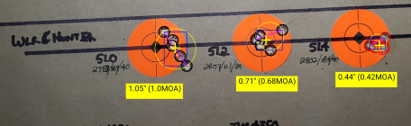

Though I understand and agree with all efforts to improve consistency, can anyone report a noticeable improvement in their on target performance as a result of using a higher resolution scale?
Yes, I can 100% assure you that I saw a great increase in my reloading consistency over the past 2 weeks going from a 10-10 scale to the creedmore scale. Thar biggest consistency increase was with ball powders.
Also with that was a large increase in my confidence in reloading charges. I also should mention my time spent throwing charges has been reduced as well.
Edit: forgot to share recent target with results
