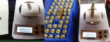

Here's 8 grams (40 carats, 123.459 grains) and 6mm Hagar cases converted to 22 Nosgar, sorted to 125 grains (+/- 0.5 grains). Sorting also got me a bunch @ 126 grains. Ready to prime once I sort out some primers :)View attachment 1305027
Sorting is a little faster with a digital. This scale has been pretty good for about 3 years.
I am curious about your pictures, as I have not previously seen anyone use a cushion or liner on top of the scale plate when weighing things. Is that something you always do or unique to those instances?
When using my Mass Standards, they do not touch a metal pan, fingers are gloved.
