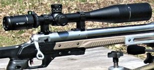

Did'nt get the PM yet but here's my advice. On a stock with a mag well,
I bolt in a aluminum bolt then transfer the center screw. Blind mag stocks
like Choate, I bed the block in epoxy then transfer to that. I do not use
just the 2 screws because of the weight involved with 30 inch heavy
barrels. The front screw on a Savage does not have a lot of threads.
and for this reason I always include using the center screw. Peace of mind
with all that weight hanging out there, and shooting heavier wild cat loads.
Did a BR build on a MDT Oryx with my real short 284 Winchester cat. You
can see the screws holding the block in place in the mag well.
