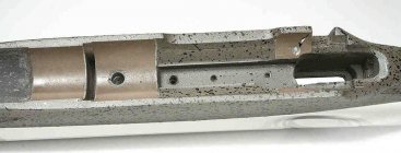

that is a H&S precision stock and they do have an aluminum bedding block. AT least on their xp100 handgun stocks we Normally torque the front bolt between 25-30 in-lbs and just tighten the rear screw snug but not tight.
But what has me concerned is what is making that mark (marked with arrow on pic)? The only thing in that area is the front pin holding the trigger in the action. if the pin is too long or stuck, it could cause the action to not sit correctly in the bedding.17MIV Bedding.jpg
But what has me concerned is what is making that mark (marked with arrow on pic)? The only thing in that area is the front pin holding the trigger in the action. if the pin is too long or stuck, it could cause the action to not sit correctly in the bedding.View attachment 1679696
That area seems to have been carved out for some reason, I don't see a correlating protrusion on the bottom of the action that would require that space. It's unusual and not sure why it's there.
I shoot a lot of xp-100s in their original pistol configuration. Torque the front action screw as normal. The rear screw being an 8-32 you just make snug. It doesnt need torqued to 1/4-28 specs! The mark on the right side kinda looks like it corresponds to where the trigger pin is, is there any depth like it was relieved with a mill?
