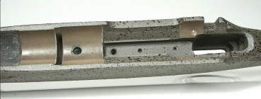

From the picture he posted of the stock and bedding it does not. Looks very suspect to me :)
Oh freakin A
is that of the OP's rifle stock?
If so
1) try relieving the bedding in front and on the sides and bottom of the recoil lug
That can be a problem issue / Dremel is your friend unless you have a Mill
Only the rear of the lug should touch
Way back in the beginning, nobody relieved around the recoil lug, because they didn't know better.
Including big name proffesionals that touted the best of the best bedding jobs.
That aspect got figured out later
2) Make sure the bedding in the chamber area does not put upward force on the barrel when clamped in
(For example, lets say it was rebarreled once, and they never redid the bedding where it touches the barrel)
(Relieve the bedding in the chamber area to fully free float the barrel)
Then see how it shoots
if the action was bedded right it should not move much upward or downward when you torque the action screws down.

Couple replies: First, I checked the front action screw: It protrudes out of the bottom of the stock bedding surface by .180". The screw hole has been milled out inside, so there are no threads showing inside, and the hole is .211" deep, so there are extra threads in the action to engage, and there is clearance above the screw head.
Second, with tightening and loosening the forward action screw, it barely moves, I can feel it slightly cinch in, but barely any movement felt.
I do believe the bedding is an exact imprint of the front of the action, the recoil lug, and the back of the barrel, there is no gap in front of the recoil lug in the epoxy.

This is an example in wood but you get the idea
and if you have a wood stock you dont care about to train your hand on, even better
Relieve all around the recoil lug except the back
The back is the only things that needs to stop the action from going backward,
the front does nothing for it
the sides do nothing for it
Relieve the Bottom, sides, front ---it doesnt need much, just clearance
The problem can stem from any atmospheric dust, a hair, lint, water, moisture etc, getting in between that
Perfect Line fit
and with 4 surfaces nothing should be touching/ interfering with, it can contribute.
Perfect Line fit

I do think this one has a fully contacted recoil lug, everything from the front of the action to a ways down the barrel.
do one thing at a time
First relieve around the recoil lug
The bedded chamber area may not be hurting anything
but if you relieve it too, do it after you test relieving around the recoil lug
Rebedding the chamber area if you want afterward is easy enough
Do so with the action torqued in properly if you rebed it
Do some research or ask advice here about relieving the weight of the barrel hanging off the end if you rebed the chamber area
When I bed I put the rifle vertical so the barrel weight doesnt hang down / Neutral
if there is say .0005" between them due to the barrel sagging and squishing the bedding while it cured,
that can vibrate
Some others have different methods such as even suspending the front by the barrel for negative (upward) deflection in that area, which would create a constant upward pressure in the chamber area
Whose to know how your barrel was bedded?
