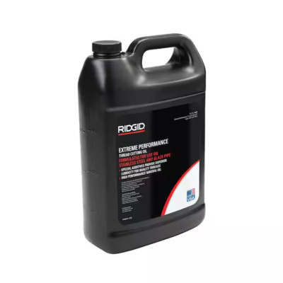

The Ridgid thread cutting oils that say low odor, DO NOT have a sulfur smell. I've got Dark and Nu-clear and neither do and they are at least 5 years old.
If you’re referring to this stuff…my wife makes me wash my clothes I wear in the shop separate from everything else because of the sulfur smell. Everyone that comes into the shop comments on it. If this doesn’t stink, I’d hate to smell the stuff that stinks ;)
If you can tolerate the smell of automatic transmission fluid, you can tolerate anything.
