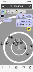

Today I shot a .243 at 600. The action was a 40x, but I have had equal results with a 700 in a dedicated Open stock, with a PTG single shot block.
The .243 shoots flat groups like this. That is pretty comparable to any more expensive gun’s potential. The wind was up to 22. It was a small match, after mud road flooding, but it did win and managed the only clean today, after this relay.
Those were DTAC’s, .243 Win. This gun is not limited to 600 capability, it’s just that where I shoot club 1,000 matches, it’s like a little annual match, every month. (The target velocity of a DTAC at 600 from a .243 is similar to the velocity of my recently shot Berger 195/rsaum, at 1,000; that saum at 600 would have saved shot 14, but it would have been a taller group).
Something wind wise lifted 15, but I obviously hated shot 14, and had moved right, significantly, but I hadn’t aimed higher.
