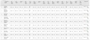

We have a league going on those targets, pretty informal. What would decent scores be outdoors?
Not sure which targets you’re referring to but for the factory & custom class guns & the green 50 yard target most are shooting 240 & up. Been a couple 250’s.
The new 50 yard & UL guns upper 240’s.
The 100 which everyone shoots we’re seeing between mid 220’s to 240.
As to what’s decent, only the group & conditions your shooting with/in can decide that.
