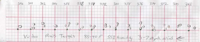

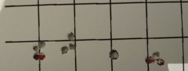

I spent most of the day at the range, it was hot 85-90 F and 70% humidity. Mild 4 -7 mph winds. I played with my CZ 457 Varmint waiting on the temps to climb, and did some ammo testing. Afterward I pulled out the Vudoo and established baseline velocities for bare muzzle, bare tuner, tuner with the noodle slide ring in various posiotions at 90F usin a lot of SK SA that shoots good, not great but good enough to do velocity checks with. Twnety five rounds had an ES of 36 and a SD of 9.6
I had finished and was waiting on a cold range and saw a box or RWS target that was most empty from the CZ testing and decided to finish off that box in the Vudoo while waiting. First two five round groups had vertical stringing so I brought the tuner down 2 clicks and the third ( 5 round) and fourth (7 round) groups.
People can can set and forget all they want but sometimes a click can make a difference. Centerfire benchrest and F class shooters have know that for years The two rounds on the right in 4th group were pure wind but those 2 clicks made that vertical go away.
I had finished and was waiting on a cold range and saw a box or RWS target that was most empty and decided to empty that box in the Vudoo while waiting. First two five round groups had vertical stringing so I brought the tuner down 2 clicks and the third ( 5 round) and fourth (7 round) groups.
People can can set and forget all they want but sometimes a click can make a difference. Centerfire benchrest and F class shooters have know that for years The two rounds on the right in 4th group were pure wind but 2 clicks made that vertical go away.
That'll never work Jim! Lol! It'll shoot small but it's not tuned. Lol! ;) :D:oops:o_O:)
To a degree...I actually agree with that tongue in cheek comment though. You can clearly see the poi is lower on the latter groups. If you're running my or a Harrel's, I'd love it if you went 18 marks in the same direction as your last adjustment. I'd bet the poi moves up and you're within 2 marks of dotting up again. Is it possible for you to do this for me? If not today, conditions might be different but not likely enough to change the outcome a lot. Here, we had a huge difference in conditions overnight though..fwiw. Much cooler today.
Ideal would be three 5 shot groups at 16,18 and 20 away from where it dotted up in your pic
I had not seen that, thanks for poitning it out, here is a overlay of those 12 shots, almost .5 vertically. I will have to play with that ammo, I have 3 bricks of it on the shelf and my CZ's hate it. Yep I will head to the range again tommorrow if the wife will let me out of the house. I will start where it is at and go down in 2 click incs

Almost identical conditions as yesterday bvut a bit windy. 3 - 7 MPH. I waited for slack tails on the tuner workup but shaded my shots on the practice target. Both the points I dropped were almost exactly at the POA but I missed the wind drop off. Low X count but I am happy with it considering it was with $8 a box ammo shot by a rookie. On ARA unlimited would have probably been a 2000 maybe 2100 depending on how the plug treated me
edit just did a composite in OnTarget and for the twenty five shots it showed vertical of .321 inches and a CEP 95% of .297 inches. Width was .562 CTC so I still have a lot of room for improvement for my horizontals but I don't think I can get mid price ammo to shoot any better. Only thing that can help this tune is lots of trigertime in windy conditions. Next I need to shoot the same target with CX, and a couple of flavors of SK see if the tune holds or needs a click or twoi.
