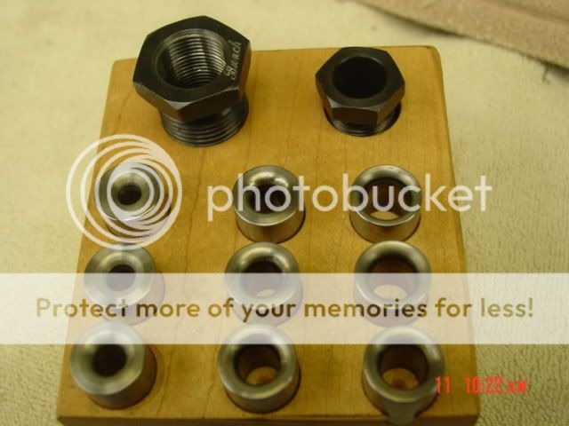

I use my case sizing dies shown below.
You might go on some of the various forums and ask. I sold about 200 sets, but they moved too slow to continue selling them.
