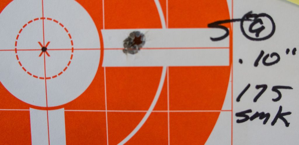

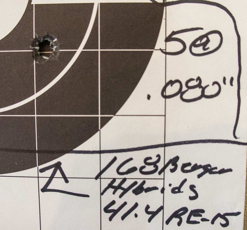

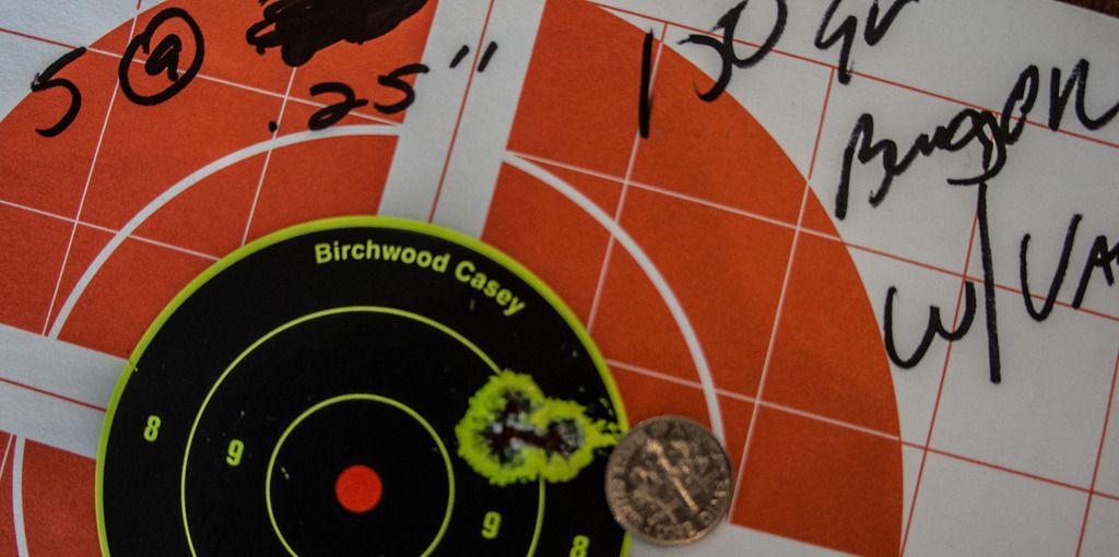

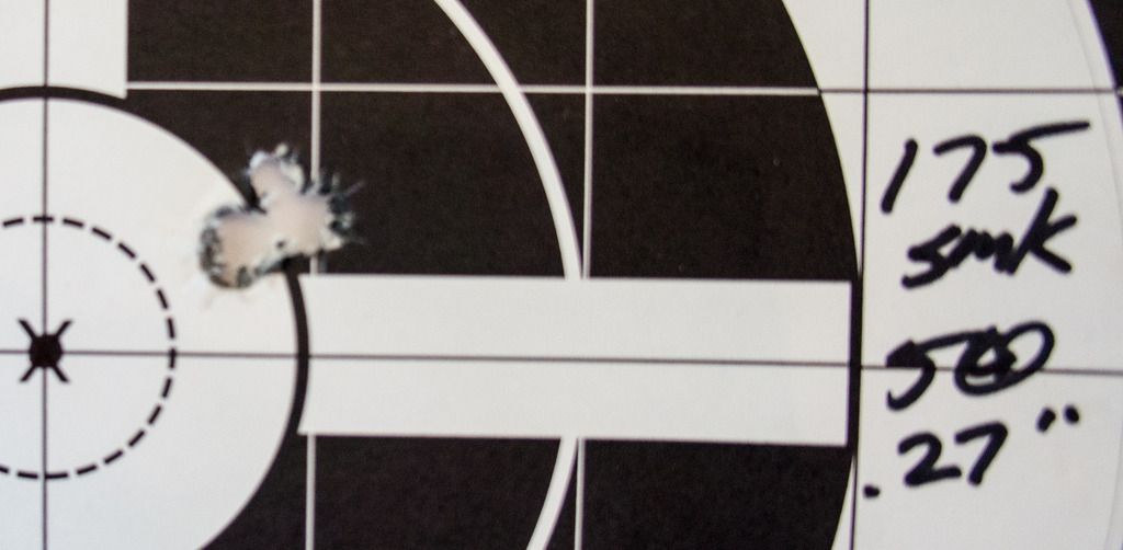

Savage Target Action
Criterion 1 in 10 twist 28" .308 barrel
XLR Industries Element chassis
all 5 shots @ 100yds seated or prone with a Caldwell rest or a SEB-JOY POD
Sorry the first two pics are the same shot, my bad
I could go on, but point made
