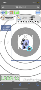

I set back two 6.5x47’s recently. One was a Krieger, the other a Brux. Both had over 3K rounds on them.
I cut 2” off the chamber end, then treated it as a new barrel. Both came back to life exceptionally. So essentially I cut away 4” of barrel total. There is still some alligator skin but they are humming.
The Krieger is on a hunting gun, I worked up a solid load, shot it in one BR match to prove it out, and put it back in the safe. I’ll save that for speed goats and deer. Maybe a song dog or two.
The Brux is on my 600 yard BR gun and so far this year I’m doing pretty well, winning some light and heavy events, and taking first or second overall in two gun every match this year. Clay W @Mulligan Has the records posted on here somewhere.
I’ve got a brand new Krieger and Brand new Brux sitting on the lathe bench I’m going to get spun up and ready; but for now I’m going to keep letting the 3K+ round 6.5 make the 6mm guys mad.

E-Target is 47 with setback Brux, Paper target is with a turned down and setback Krieger originally from the bench gun. All 600 yards
