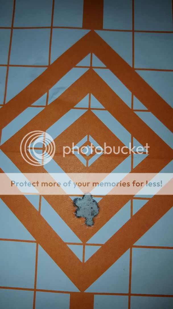

I want to thank all of you for all the great information given freely on this site. My shooting and reloading.tecniques have improved greatly since i joined this site. Now i don't have one of those custom benchrest rifles. I just have a home made savage. Target action with shilen 6Br prefit in a SSS benchrest stock. Had Fred at SSS time and true and install his benchrest trigger and bed the action. One day i hope to have a custom 6PPC I can shoot bugholes with. Until then i will keep working with what i got.
Anyway i started with this and was pretty happy. Berger 105 hybrid, 29.4 gr varget, jammed .010,.br4s
Then i went to work on all the stuff on this site. I am just trying it all. Finding out what works and what doesn't.
Did seating depth test and found .005 off shot really well. Then did a new load test from 29.3 to 30.1 in .01 increments. All were good but 30 was best. Then i sorted bullets by weight and base to ogive. Bergers are really consistent but i did cull a few. Then i weigh sorted my lapua brass. Culled a few of them. I do anneal and do it a lot more often now. Then i found neck turning. Always been afraid try it. Its easy. I know it improved my concetricity and i believe it.improved neck tension. Bought the 21st century shooting hydro press from advice on this forum. Now i sort those with the.same seating pressure and the use my 21st century concentricity gauge to sort out the best. The target below shows my improvement. Now if i can just improve the consistency of my reloads. Going to try some berger 80 gr flat base now. This will be my long.range load.
ES 16 SD 5.2
3 or 5 shot groups?

Well i have learned so much reading these threads. All the things i am trying.i learned right here.
It is entertaining to read all the strong opinions here. My thoughts are what works for you. But you will never know unless you try it.
I have a whole new group of.ideas to try now.
Ordered a harrel die and some bushings. Ordered the k& m mandrel neck sizing kit. Going to try to get neck tension more consistent. I know what seating pressure works best with my hydro press. That will be a learning experience.
Ordered some berger 80gr flat base. Here they work really well for short.range in the 6BR. Going to try H4895 first. Have a few ideas.
The 105 hybrids will stay my long range load. That is if i ever find a place to shoot 600 yrds.
Any other suggestions.
