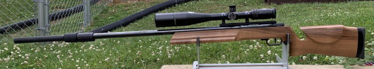

Tim,
That post above, i only have shot that rifle in one benchrest match.. i was indoors at Kettlefoot on a two pc rest setup. IR50/50 10 shot target.. 250-13X i thought that was pretty darn good for that rifle..
A tuners overall effect depends on the stiffness of the barrel. If you have a long thin taper you are going to see more barrel whip than a shorter stubby barrel. Since you say you change settings according to your ammo Sounds like you have a taper barrel with a good amount of flex. I would use my chrono and see if I could match the FPS to a known ammo's setting.

Just my opinion here - tuners (traditionally) are a mechanism of fine tuning. When I initially set up a barrel, the placement of the crown is the critical issue. You need great baseline accuracy to start with, or a tuner will never get you there.
But the system needs to be tested exactly as it would be in competition (whatever your discipline is). Testing without a tuner is just too large a variable to hope to learn anything reliably about how the system will perform with it (if tested without).
When I finish a barrel, I test it just as it would be used in competition - with the tuner in a midrange setting. I look for good baseline accuracy - and round groups (preferable without vertical / horizontal dispersion or "stringing"). If I don't see it, I set back the crown incrementally and retest. Something in the .450" outside edge with roundness is probably workable (if I had to put a number on it). Then start your tuner testing.

This is just my .02 cents. I start testing WITHOUT the tuner first., because I like to shoot the scoped half of the match without the bloop tube / tuner on my rifle acting like a wind sail. My thinking is if a rifle will shoot well without a tuner it will really shoot with a tuner on it.
