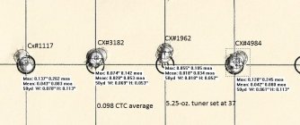

First off I know nothing about CF, but the biggest difference is that you can match the load to the rifle with CF. in RF you have to find a consistent lot to tune with, so how to do that especially when you haven't found the tune yet. in your example, you develop a load to match the weight already on the barrel, again with RF you will be testing multiple lots to match the weight on the barrel. it is easier IMO to find one consistent lot first then tune with that lot. and again I know nothing about CF, but in RF you are timing the bullet's exit from the barrel ideally with the correct amount of weight. it is possible to find a setting adjustment that places the correct weight forward of the muzzle where you can shoot multiple different lots and not touch the tuner at all, ever again. all you need is consistent performing ammo.
as you noticed I said correct amount of weight, because you can not adjust the load to the weight, you adjust the weight to the load in RF so you can time the bullet's exit to what the barrel will shoot at its best.
if you just have weight on the barrel without it being adjusted correctly, it will only narrow the lots that could shoot in that barrel. RF is all about exit timing of the bullet.
here is an example- rifle a Match 54 after finding a setting I could shoot 4 different lots that average 0.098CTC this is a target shot in a match using Lapau Pistol King which I have never shot before and randomly purchased using the same tuner setting. was I lucky, only that the PK shot consistent to allow me to shoot that target.
Lee
