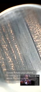

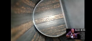

@LVLAaron here is a quick grab for you. Consoder I still have the screen protector film on the display and also that the image is a little degraded because of a digital cameras ability to catch some screen refresh. I would also ask you to keep in mind I am not a photographer...lol. That said the image is better in person of course and if you zoom in you will see more detail with little pixelation. The last point to consoder is thats a dirty 6mm bore and I discovered this eve that my 6mm mirror was broken so had to use the 22 mirror.
Ps the screen is not that blue to naked eye thats a result of the digital pic.
Hope this is helpful.
Andy
Andy
Is that screen protector blue? I see a little blue tab up on the right top side.
