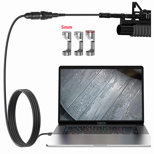

I'm looking to get the Teslong, probably the WiFi version NGT100W, just have one question, will that unit have a 45 degree mirror to look at the bore side directly that will function on my 20 Caliber bore?
The listing shows it only comes with .22 /.243 /.30 /.38 /.40 size mirrors, that means NO on .20 in my thinking, but I am not sure. The unit says it will work with 20 caliber, but not sure if that just means looking down the barrel, or with a mirror.

www.ebay.com
Teslong Upgrade Rifle Borescope 0.2in Gun Barrel Camera Short Focus Bore Scope | eBay
Find many great new & used options and get the best deals for Teslong Upgrade Rifle Borescope 0.2in Gun Barrel Camera Short Focus Bore Scope at the best online prices at eBay! Free shipping for many products!
www.ebay.com
From a metric conversion standpoint 5mm = .1969" ... going to be pretty tight fit inside a 20 cal bore. I think the .2 in camera is sized appropriately for the .22 cal barrel but would have some problems in a .20 cal.
for 7mm and larger barrels the extra mirror kit helps tremendously with focus especially in a .308 barrel
