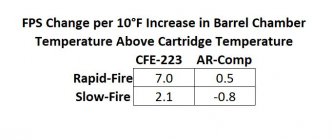

I am following up on an issue previously raised and discussed with Ned Ludd. What is the effect of a warm (or hot) barrel chamber on the powder temperature and combustion? Also, I want to further address the question: Does any of this temperature-sensitivity and standard deviation measurement have any bearing on where your bullet hits down range (assuming perfect shooting technique and wind-reading ability?)
I performed additional tests trying to simulate shooting the second 10-round string of cartridges at 66°F in a rapid-fire sequence where cartridges are in the hot chamber for 5 seconds before being fired. I also simulated a slow-firing sequence where cartridges are in the chamber for shots 11 through 20 for 30 seconds each. I measure barrel chamber temperature with a digital oven thermometer with long stainless steel probe inserted into the chamber against the chamber wall.
Responses of a temperature sensitive powder (CFE 223) and less sensitive powder (AR-Comp) were compared. Unfortunately, the runs for each powder were about 15°F different, so I had to go through a normalization process to compare results. Finally, I plugged the muzzle velocity spread into a ballistic program based on means and standard deviation for each powder and shooting sequence and estimated the variation in impact point at 300 and 600 yards for both powders.
Interim Conclusion: Powders do get heated during rapid- and slow-fire sequences at chamber temperatures between 108°F and 142°F and result in significant changes in velocity. Degree of powder sensitivity to chamber-induced temperature change does significantly affect magnitude of velocity change. Resulting velocity variation does significantly affect impact spread of bullets at 300 yards and 600 yards and your point score and number of X’s at the end of the day.

Agree with your conclusions Bill.
Soaking a round in a hot chamber is an effect one must understand and account for as a competitive shooter or varmint hunter.
Each game is a little different in terms of the tempo and if the shooter has a chance to adjust. When I started using CFE223 for prairie dog loads, I got into the habit of updating the dope as the morning and temperatures changed. I don't use it for Service Rifle, but it is manageable for PD work as long as you have a Kestrel or equivalent.

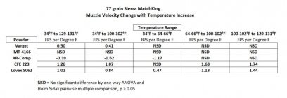

The final temperature velocity graph follows with analysis for 4 newer powders to consider in comparison to Varget. IMR 4166 and AR-Comp were the best performers to consider as substitutes if you shoot at temperatures above 70°F. The temperature sensitivity of Lovex S062 was more closely comparable to that of N140 or CFE 223 than to Varget. I’m moving to working up accuracy loads for IMR 4166 and AR-Comp and will update the online review at:

AR Comp still smokes them all in the practical shooting range of say 50 F to 110 F. Lowest spreads too.
AR-Comp is by far the best powder you can (could?) get. It provides almost unreal velocity, incredibly low SD, and everything I've shot it in... I get benchrest sized groups, even from an AR.

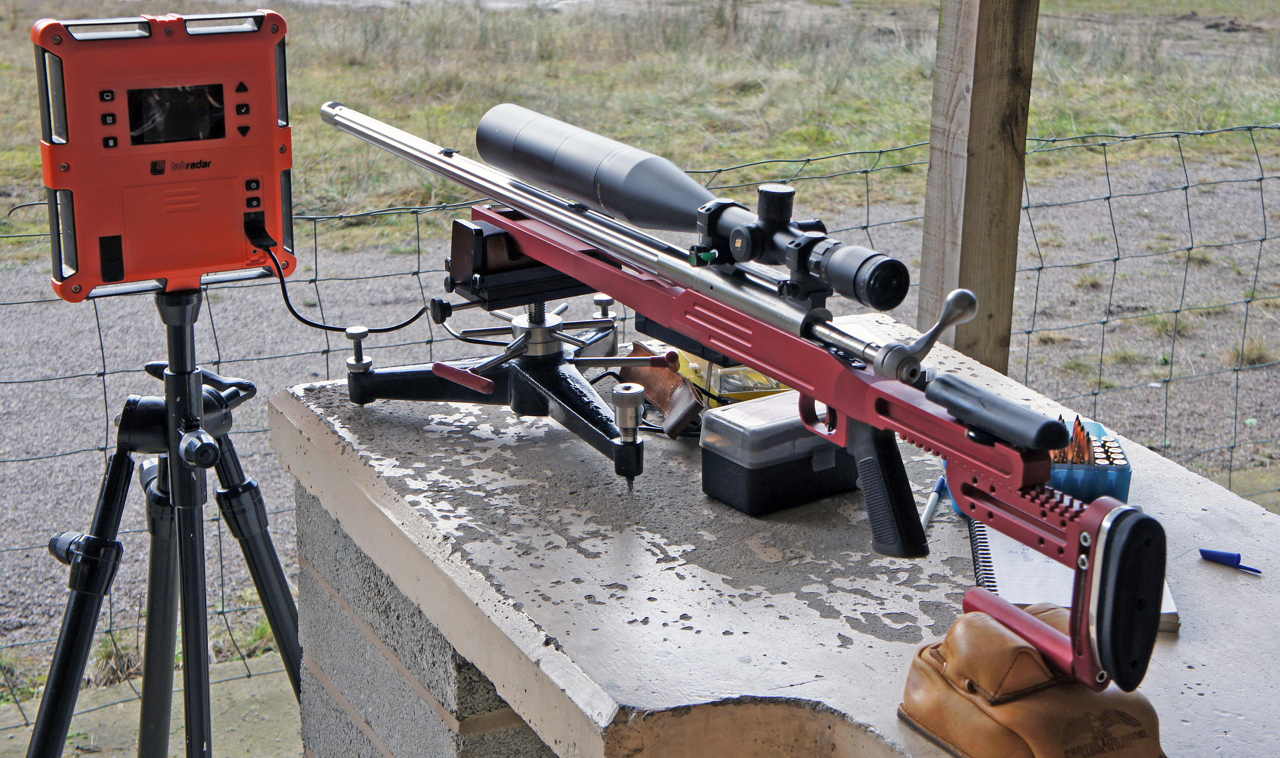

I've identified 27 'REACH' compliant grades as H4895/VarGet alternatives that are on paper anyway available to us in the UK. Three have unfortunately just dropped out as RUAG Ammotec UK has stopped importing the Norma range less than three years after reintroducing it. I managed to test most of the 16 extruded grades in the list last year in a 223 Rem F rifle using Lapua brass and the 77gn SMK alongside the two benchmark grades H4895 and VarGet. Of these, three aren't sold in the US - Reload Swiss RS40/50/52.
Writing up the issues and results of this stage has just started and will appear in sections in targetshooter.co.uk over the next few months.
A few initial comments. As usual burning rate charts and QuickLOAD show Viht powders as slower burning / producing lower pressures than usually applies in actual load combinations. Likewise, Lovex S-series single-based extrudeds, but in reverse - ie shown as faster burning / producing higher MVs than turns out in testing. S062 (SW 'Precision') appears to be rather slower burning than VarGet - in the 223/77 at any rate. Viht N140, N540, and surprisingly N550 gave outstanding results although 550 is rather heavily compressed in this application and were excellent VarGet replacements. Note too this was 10-year old N550, not the recently reformulated version. (N140/540 were newly purchased.) As various posts have noted, AR-Comp is a superb powder in this application, rather faster burning than either H4895 or VarGet though. IMR-4166 Enduron turned out to be a very 'odd' powder in the 223. First, although there is plenty of published data for its use in larger case-capacity numbers such as 308 Win, nobody, and I'll repeat, nobody publishes lab-tested pressure measured data for the 222/223 and similar small cartridges other than Hodgdon itself, and that with a very low maximum for 223/77 well down on the apparently comparable H4895. I loaded it up to my H4895 top charge weight in 10 X 4-round, then six X 5-round steps getting lower MVs than QuickLOAD predicted and hitting compressed status at a lower weight than with H4895. The top couple of charges that took it to my H4895 weight produced rather lower MVs than the ADI/Hodgdon grade, but also unlike the Hodgdon grade started to show pressure signs. The rifle chamber is minimum SAAMI case with a freebore between Wylde and the PT&G ISSF, likely somewhere a bit over 100 thou' allowing 2.400" COAL with the 77gn SMK and more room for powders like N550 and 4166.
