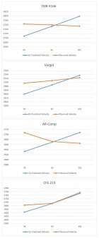

QuickLOAD is worthless for predicting temperature sensitivity (or more specifically predicting the slope of the temperature/velocity relationship for the powder.) It appears to assume that all powders are temperature sensitive.
I went back and assessed the function of QuickLOAD in predicting temperature sensitivity with my data. First I adjusted the Ba (burning rate factor) value so that it was calibrated with the data I had for powder, bullet, case volume, temperature and velocity. I then had QuickLOAD calculate velocity predictions for the three temperatures at a given powder charge. The data are below. QuickLOAD assumes that the slope is positive for all four powders I checked regardless of whether the slope is positive, negative or flat.

And that right there is why Bill is testing. And thanks for sharing your hard work.
It just points to the areas where more work is needed in the models, it doesn't condemn them.
