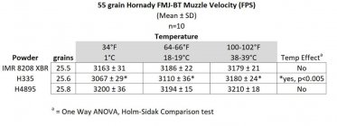

I am in the process of identifying some substitute/replacement powders for Varget and IMR 8208 that I use in XTC high power matches with a .223 service rifle and with practice ammunition. A first step for me was evaluating temperature sensitivity of the powders. I have attached the data panels and graphs for tests run with 77 grain Sierra MatchKing and 55 grain FMJ-BT bullets that may be of general interest.
These are included in a draft of a review on my website which has more information on the methods used and conclusions.

I only tested H4895 because I was looking for more easily obtainable powder than IMR 8208 XBR to use in 55 grain practice ammunition and had an underutilized supply on hand since I historically have only loaded ammunition with it for my Garand. H4895 performed much better with 55 grain bullets than I had expected it would. In retrospect, it would have been useful to look at its performance with 77 grain bullets.

I don’t believe the effect is occurring to a significant extent under the rapid-fire conditions of my study. I recorded the mean and standard deviation of the two sequential 5-shot strings for each powder. If you look at the means from 34°F tests which were run first when both the cartridges and the barrel chamber were coolest, the second test mean velocity was lower than the first test mean velocity in 6 out of 9 tests.
