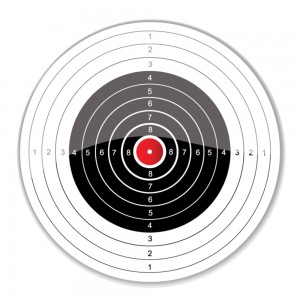

The below plastic target, I have 2 and they just won't wear out. I will check and see where I bought them from.
