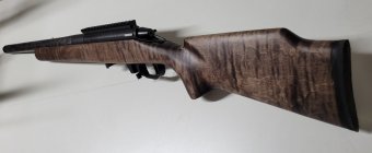

After 10-12 years of shooting aluminum chassis and stocks made with some sort of composite, I felt it was time to get back to wood.
Maintaining the form, fit, function of more modern stocks was important, but I wanted to gain the warmth, feel and beauty of wood.
I looked around and didn't see what I wanted, so I decided to make it myself.
The Process:
- Source curly maple blank
- Carve (rough pass) with router
- Contour and smooth (fine pass) with router
- Cut the inletting (action, bottom metal & barrel channel)
- Sand... there was a lot of sanding!
- Fit recoil pad with belt sander
- Add picatinney rail for bipod (drill and counter sink t-nuts)
- Drop in pillars (checking action/bm fit, alignment & feeding from magazine)
- Epoxy bed action & bottom metal
- Apply tung oil finish (2 coats cut 1:1 with mineral spirits for deeper penetration, 4 full coats)
- Protect with final coat of beeswax
The Results:
I have several more blanks on hand, now what to do with them?...
This intimidating piece of maple might become home to a Zermatt Rim X, but need to find an action first.
I am sucker for wood.

ROUND 2 - Compact, Lightweight Hunting Rifle
Origin SA, Competition Bolt with TT Diamond.
PVA, 16" Proof CF 308 Win
Hawkins DBM
Pillar & Epoxy bedded
6lb 6oz as pictured
First five shots through this one... two sighters at top left corner, followed by a three shot group on the bottom left.

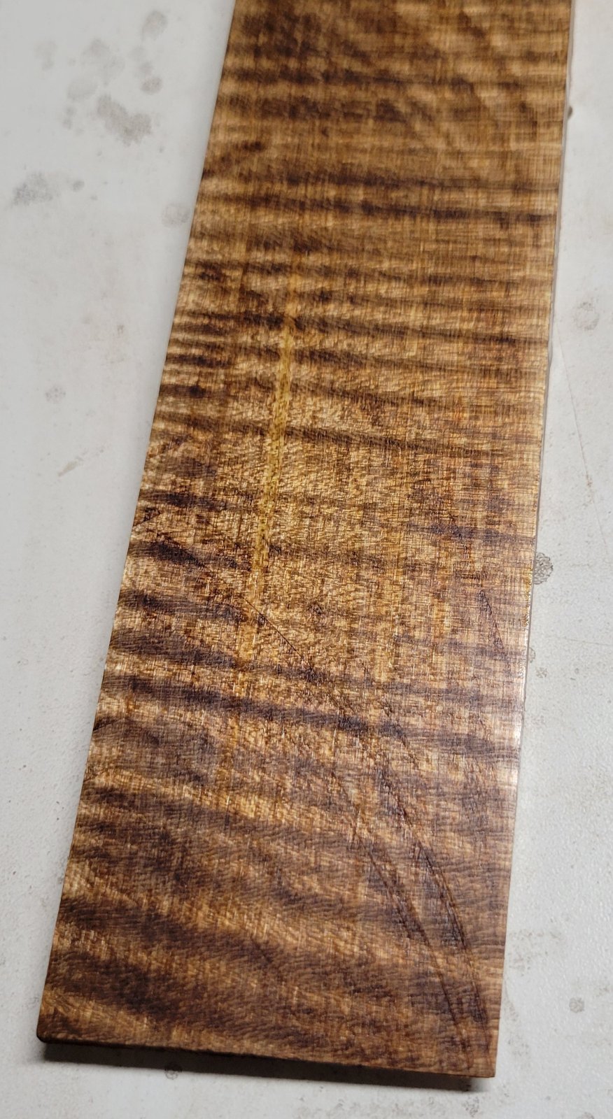

You'll have to excuse the saw marks, I didn't bother sanding them out just to test some color combos on scrap wood.
Coffee Brown, Copper (Med Brown / Red), Vintage Maple
This one really "dances" in the light.

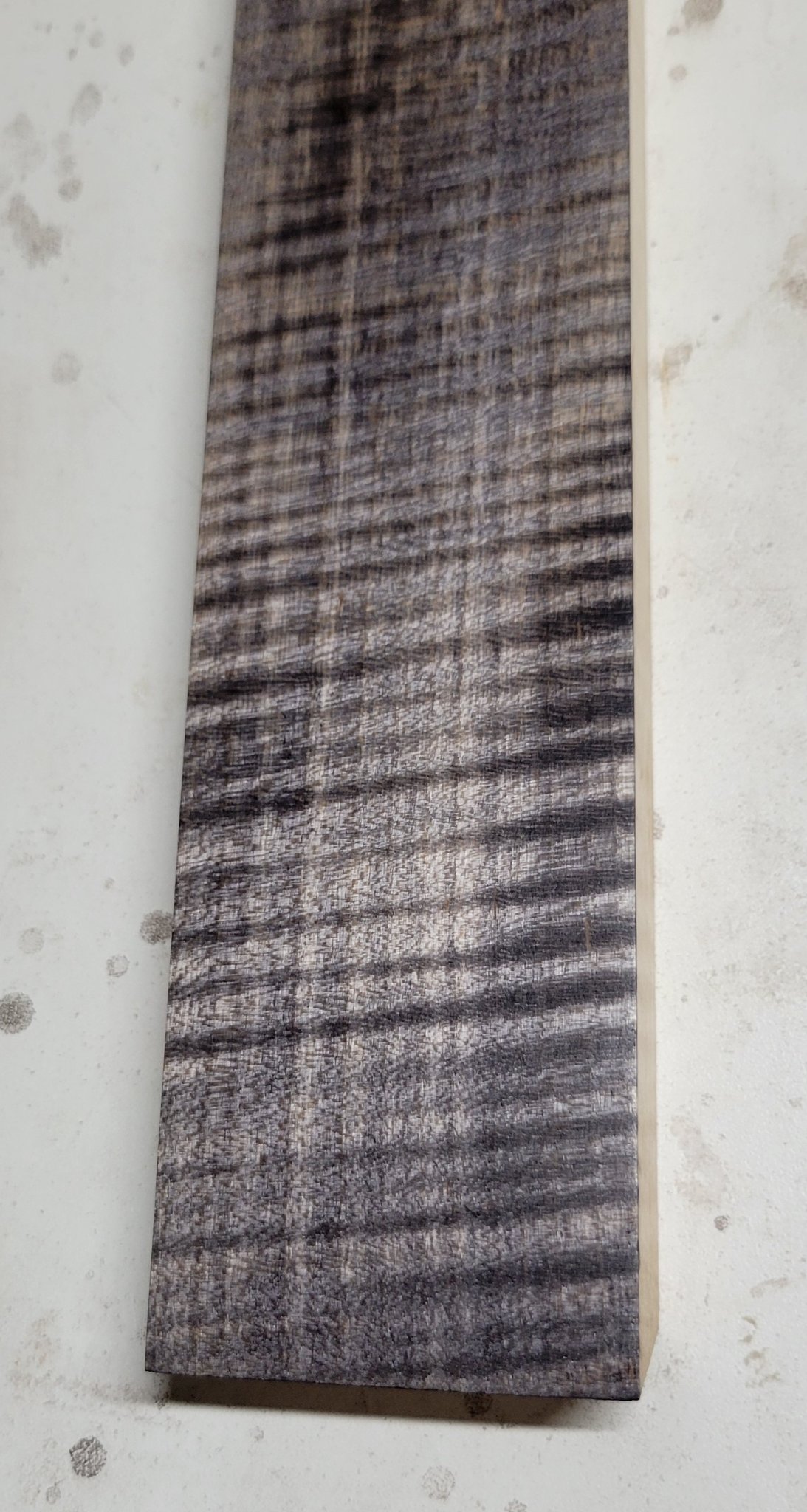

Black, followed by thinner coats of black. Reminds me of the salt and pepper laminate stocks and would look good against black or stainless barreled actions.
Mix a batch 70% black with 30% medium brown 1st coat, 2nd coat reverse color ratios. 70% brown 30% black
Here's a couple test panels I'm working on for a customer.
Trying different application techniques and not sanding between colors using straight dye undiluted.
Red orange vintage amber to natural fade, copper burned in on bottom with a kiss of brown n black lower edge
20241122_111331.jpgsame colors used only i completely covered in red and sanded back leaving the red in the soft grain.
