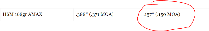

Couple reviews I found that has some average accuracy data posted. Looks like these guns love hsm 168 ammo. One gun was sub 1/4" the other was .37" for average group size. So it looks like they are very dependant on ammo. Note the velocity difference in the second review. Its as I said in the other thread they used a reamer with minimal clearance that puts these bullets right next to or into the lands. Only way you get the same velocity with 4" less barrel.
Would I call these guns 1/4 moa guns? If your only talking about 3 shot groups and you find the right ammo they might get near there and stay near there. They would likely do it with hand loads quite reliably.
