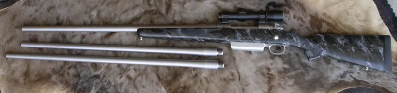

The rifle below is a left-hand Montana 1999 with 300 Wby, 375 H&H, and 458 Lott barrels allowing one rifle to be a complete three-gun set for Africa. The barrels can be changed in the field,though not between shots at charging cape buffalo).
