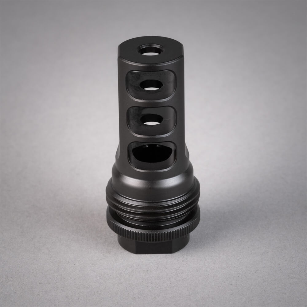

I've never attached my can directly to the barrel nor do I think I'd want to. All my rifles with threaded barrels have one of the Silencerco ASR mounts directly to the barrel so I can easily use my can on different rifles.
Watched a can getting launched down range from a quick attach mount last week. Luckily there was no baffle strike. I will stick to a screw on mount.
IMHO, that can't happen with the Silencerco system if the silencer is installed properly.

Yea, well, I've managed to not install my Hybrid properly and shoot it off of the end of a 308 ... twice.
I still like the system, but foolproof it aint.

I have a Hybrid also and I launched it once. In fact it drilled a new hole in the replaceable end cap. It would be almost impossible to have a baffle strike with the Hybrid because the baffles are sized to be used from 45 cal down.
I did not have a good experience with Silencerco when I emailed them about my launch. They promised me they would send me a new end cap and then ignored me when I reminded me. (I ordered 2 silencers 5 months ago and none were Silencerco because of the way they handled my inquiry). They did tell me that if you actually use the ASR mount a good bit the springs get weak and need to be re-tensioned. They sent me a video of how to maintain it. Like many mechanical things it takes maintenance to work properly. I feel like it is Silencerco's fault for not educating people about the necessary maintenance.
ASR Spring Maintenance
