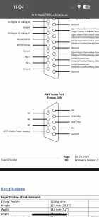

When I got mine, it wouldn’t power the scale-
I did reset umteen times…got tired of here that crap- texted, called, emailed…
Come to find out it was the A&D FX120i scale board itself - quick call to them, chatted with an engineer-I got a new board for the scale
pin #9 coming from scale didn’t show voltage when JUST the scale (stand alone only) was powered up
I’ll throw that out there for anyone else who might have troubles
