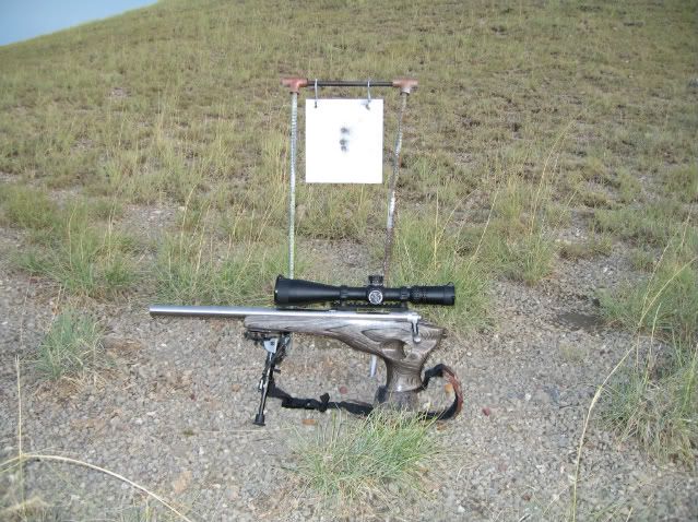

Here's my coyote rig for this year. Sav. Super Striker 22-250/8 twist McGowen/65 JLK Low Drag @ about 3100. These are 1st shot connections at 325,400, and 525--
I'd take a look at the JLK Low Drags for coyotes out of that rig of yours. 12 twist should stabilize the 60, no problem.
