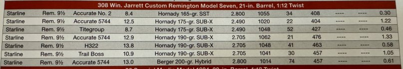

Check out the Hodgdon Reloading site. I'm seeing more data on subsonic loads with alternative (non Trailboss) powder for a bunch of chambers.
I just learned there is a new Hornady subsonic bullet line called Sub X. The Hodgdon site shows data with Benchmark - 175 Sub X/12.8 benchmark/1066 fps.

Just discovered this thread.... I have a 1/10 twist 308, Lapua Palma SR brass, and Hornady 190gr Sub-X bullets. Trail Boss is unobtainium and I am looking for alternative powders. Hodgdon's load data shows 13.3gr H4895. I have a bunch of 8208XBR which is very close in terms of burn rate. Has anyone tried any 8208XBR loads?

Hodgdon will warn you not to substitute any other powders for the H4895 reduced load data. This is because of the dangers of powder detonation, as well as inconsistent ignition.

THanks for the advice. Where is this warning? I don't see it in their subsonic load data PDF. I just finished loading up 20 rounds with 13gr 8208XBR to an OAL of 2.690. Let's see how this goes.....

Just because the burn rates are similar on a chart, doesn’t mean the two powders react the same. Flashover/detonation is a serious and dangerous event. I would not fire those rounds without further investigation.
FWIW - I reached out to Hodgdon. Their response:
"Thank you for contacting us. There are only certain powders that will work for these reduced loads with these lower case fill percentages. We thoroughly test each load and powder for case position sensitivity when developing these loads. Only powders listed would be appropriate."
Ok but 60% of a full charge of h4895 will not be subsonic. I haven't been to the range in 6 months due to multiple pretty lame reasons, but next time I shoot subsonic it will be with red dot. Also H4895 is pretty much unobtainable too. I heard it's no longer being imported. Would imr 4895 work?
