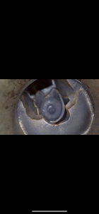

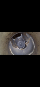

I just took some pictures and a video through the bore, looks like both of the bullets are still stuck in the chamber and they are exploded

It looks like your case is still in the chamber , bullets are gone in my opinion.

I’m guessing that the original bullet did not remain in the chamber, and you had a serious over pressure situation afterwards. That appears to be a ruptured case to me and I’d think that it would be virtually impossible to force another round in with a bullet stuck in the lands.
