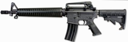

While on the subject of odd/weird AR types, there is the Dissipator. 16-1/4” carbine barrel and gas block, with full length forearm. The front sight base only retains the hand guard shield and sight post. Both shown below.
A fake Dissipator uses a 20” barrel cut down too 16-1/4” and used the standard 20” gas port location which only works reliably with certain gunpowders as the dwell time of the bullet in the barrel is to short to reliably cycle the BCG because the gas port is too close too the muzzle.
