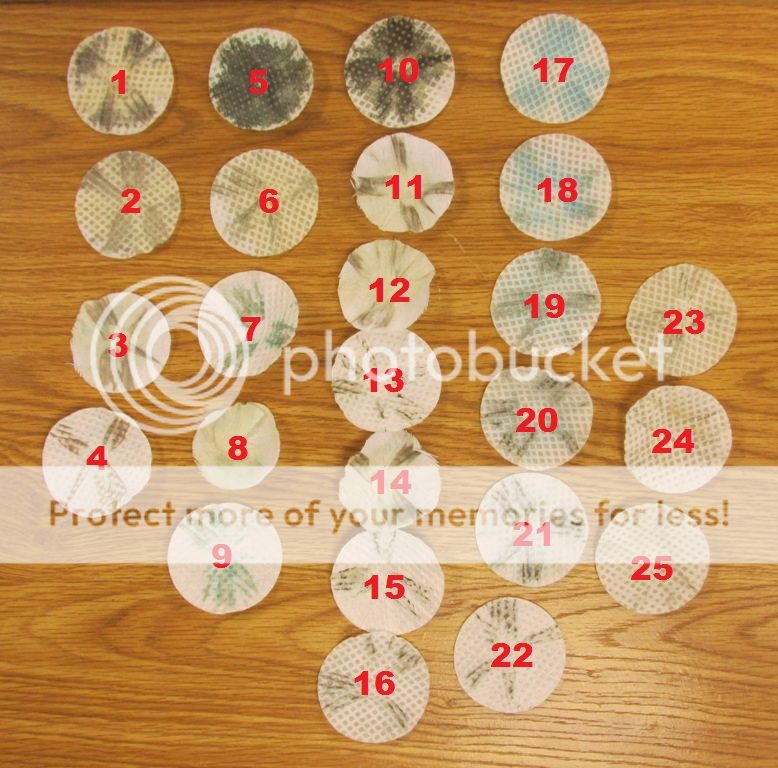

The clear plastic bottle is unmarked, and the fluid is light yellow, with no smell that I can detect. I have used it several times, and each time the results are the same. Regardless of what cleaner/solvent I use first, the patches with this ‘Bore Soap’ always show blue. Below is a picture that illustrates what I am saying. Patch #17, the first with the ‘bore soap’, shows blue, as do a few more patches afterwards.
Steps A: Patches 1 > 4 with Butch’s Bore Shine (BBS)
Step B: Stiff nylon brush with BBS (brush has aluminum stem)
Steps C: Patches 5 > 9 with BBS (allowed 15 minutes after patch 8)
Step D: Stiff nylon brush with BBS
Steps E: Patches 10 > 16 with BBS (allowed 15 minutes after patch 12)
Steps F: Patches 17 > 22 with ‘Bore Soap’
Steps G: Patches 23 > 25 with Breakfree CLP

I have found Balistol to do exactly as the OP described. Regardless of how much time I spend on the bore, I finish with a patch soaked with lighter fluid, left to dry, then followed by Balistol before storing. When I punch the bore, I get more blue.

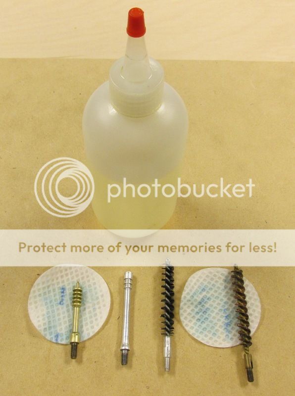

• The nylon brush has an aluminum 'winding', as shown below, and it does not react with the Bore Soap.

• Possibly, although a description I just read (MidwayUSA) states that it works with bronze bore brushes. This may be true, but do the brushes (bronze) make the patches blue? See picture, below.

Notice in the picture below how patches with Bore Soap turned blue by just coming in contact with a brass jag or brush. No problem with the aluminum counterparts.

Looks like Boretech eliminator to me
Yes! After running out of several other products, it was time to get re-stocked, so I tried Bore Tech Eliminator a month ago, and that must be it!
The way Eliminator looks in a clear bottle, the tiny amount of 'foam' it exhibits, the way it feels between my fingers, and the fact that it does make patches blue after others have been white, would seem to indicate that Bore Tech Eliminator is the "bore soap' my German friend gave me.
Alex
Eliminator really is pretty good stuff...but put some on a patch and scrub the outside of your barrel, sometime. Danged if it doesn't turn the patch blue. Go figure. It is an effective copper solvent but I don't trust it when reading a patch, after seeing blue on a patch that never entered the bore. Not sure what causes that but I stay with Patch Out and Accellerator until I find something that I like better. It works very well too, and I trust the read I get from the patch better. Just my 2 cents worth though.
