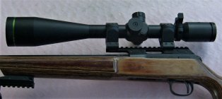

"Step three"
Had a Meuller 40X Target dot salted away for a kids build and
put it to use for the grandson. I had a set of Burris signature rings
and level lying around and put them to good use. The rifle itself
has a 15 MOA rail and with the rings, I added 15 more.
