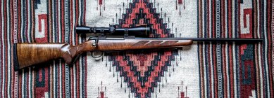

Second, I noticed very strong support for the Tikkas. I looked up the current offerings and I am sure one could work very well for me, but I didn’t really like the looks of the stocks on the Varmint models I saw. Again, they may be perfectly satisfactory, and I have not seen them in person. I did really like the looks of the Tikka sporter that was pictured, and if I found a heavy barreled version of that, I would be tempted.

@Riflecat I shot 110 savage a lot until I sold it. I know a couple of guys who run savage 12. For the money you get a Tikka action which is way smoother than Savage, you get really nice trigger and you get a great barrel. With time you will change the stock anyway. I am not saying that Savage cannot beat Tikka during a match. I just never saw it myself.

Tikka CTR T3x’s are great if you don’t mind the factory stock, etc…I just prefer most of my bolt guns to be R700 based due to aftermarket options (for instance…so many good aftermarket R700 trigger options).
