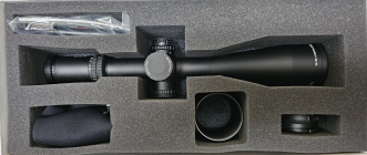

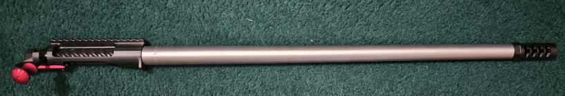

started ordering parts

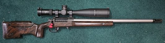

first outing done
top left 109 eld factory, top right berger 108bt ladder 33.3-34.2 varget
bottom row berger 108bt 33.7, 34, 34.1 varget
