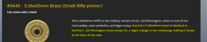

From their website:
"Starline’s 5.56x45mm brass is identical to Starline’s .223 Remington brass except for a slight change in the metallurgy making it harder at the base of the case"
From their website:
'Slight change in metallurgy making it harder at the base of the case'.
That sounds peculiar.
I'll be interested to see if I get a specific response from Starline or just a 'copy and paste' of this.

Sometimes the specifics of the hardness in the case head is because the brass is oriented toward the 556 and AR use, where the rim gets more abuse than in a bolt gun on extraction.
It might also be interesting to see if the failed wildcat cases were harder or softer than the usual up in the body, or if the thickness mentioned was an issue.
The problem with adding body thickness outside of the normal, would be that folks get the internal case volume and load tuned up expecting it to stay the same, and a change might mean needing to segregate brass that doesn't have an identification on the head. Time will tell.
