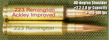

I just google 223 vs fireformed 223AI pictures. They look about the same to me. Am I missing something? Here are pictures of how its supposed to look.
