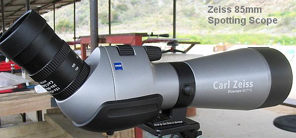

I don't know what your budget permits. I like the big Pentax eyepieces, I like the focus on the Leica, but the Zeiss is the sharpest scope I've ever looked through.
If you shop around you can find very good deals on the Pentax 100.
As for Kowa being the gold standard--that's just not the case IMHO. The ED Kowa is a fine spotting scope, but do an A/B test with the Zeiss 85 and you'll notice a difference--just like looking through a Leupold 8-25 then trying a Schmidt & Bender 5-25. The difference is quite noticeable.
I haven't had a chance to try the big Swaro extensively in the field. Reports are good. But if some-one gave me a choice of any scope, I'd take the Zeiss 85. The Pentax 100 is really huge--and to me that's a disadvantage.

The Pentax 100 is big, REALLY big. You need a serious tripod and it might be a little tough to rig on the ground like the F-Class and Highpower guys do. Here's me looking through one.
Here are my comments from San Gabriel using the Pentax 100 and a Zeiss 85 side by side:
"By contrast, the Zeiss 85mm,fitted with 20-60 zoom eyepiece) offered more eye-relief, making the Zeiss more user-friendly than the Pentax. The Zeiss' image was a little more blue,less yellow) in tone than that of the Pentax. In my opinion, color fidelity was slightly better with the Zeiss. Contrast was good, but I'd give the edge to the Pentax as it was so bright. But when it came to pure sharpness, or resolution, in my opinion, the Zeiss 85mm out-performed the big Pentax. The resolution on the Zeiss is really just incredible--the best I've ever encountered, and I've also sampled the top of the line Leicas and Swaros. I also preferred the focusing system on the Zeiss. The course-focus wheel is fast and smooth and the fine-focus knob is just about perfect. Lastly, the Zeiss weighs less than the Pentax and is much more compact. Bottom line: If I was shelling out the cash, I'd buy the Zeiss, unless I wanted superior low-light capability. One thing to keep in mind, however, is that there ARE differences between individual scope units. Conceivably, if you pulled a different Pentax 100ED out of the box and compared it with a different Zeiss unit, the Zeiss' resolution edge might not be so apparent."

When I tested the Zeiss and the Pentax "Heads up" it was declared a draw among the half dozen guys,my test panel) present.
If you want compact and easily mountable on most tripods definately go with the Zeiss. Also if you need an angled eypiece pick the Zeiss as Pentax only offers this option in the PF-80ED, which can be had for half the cost of the Zeiss or big Pentax, definately a best buy in spotting scopes!!!!).
Myself, if Zeiss made a 100MM I might be selling my Pentax PF-100ED and jumping on the Zeiss bandwagon, but since they don't I'll stay with the big Pentax for the time being.
