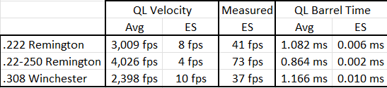

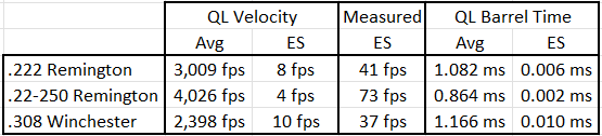

Is the observed variation practically significant? Good question @cdgaydos
My simple answer is "not really". The basis for that is how much of the measured velocity variation would be based on case weights IF case capacities perfectly correlated with case weights, i.e. the slope of the regression line on those charts has an R-Squared of 1.0. How I worked out the math was:
  1. I took the average case weights +/- 2 stand deviations, which covers 95% of expected results, and​
  2. Used the slope of the regression line to estimate the implied change in case capacities, then​
  3. Determined the change in velocity (and barrel time) using my tuned version of QuickLoad (QL):​
Given how small the velocity impact is between the extremes of +2 standard deviations to -2 standard deviations, I couldn't justify weight sorting cases.
I threw in barrel time because many people use it too......the calculated change in barrel time is also negligible.

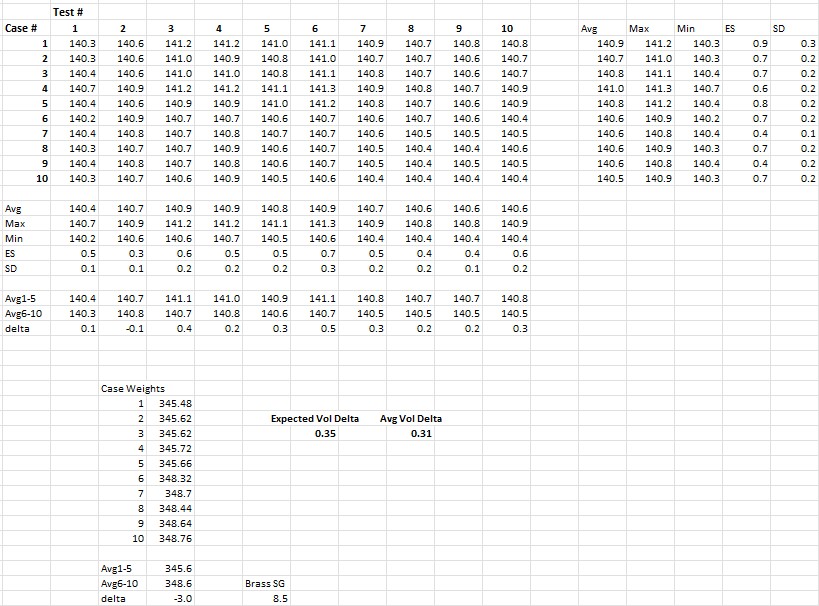

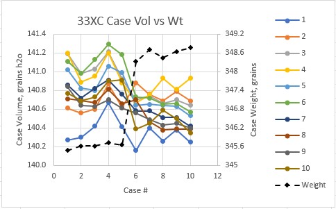

The test results below are a bad case of TMI. The cases are 33XC that had been fired once in a seasoned barrel. New cases have volume differences that are relics from the manufacturing process. Fired cases can be much more uniform in volume if the pressure histories are the same. That excludes brass used for pressure ladders or the early stages of barrel break in. Some differences in pressure history can be covered up with sizing, but all of the cases must need sizing and none of them can have significantly more spring back than the others.
I used the 5 heaviest and 5 lightest cases in the lot. Each case volume was tested 10 times to estimate the repeatability of the measurement. The case number is the horizontal axis, the test count are the series. The Bison tool is designed for much smaller cases. I used a steel dowel with 52 grains of volume to bring the case volume down into a range nearer what the tool was designed for. The tool has a warmup period. My thoughts are both the extra volume and steel dowel extended that.
There is a lot of noise, but the case volume tracks the case weight to a significant degree.
This is the raw data.
If the differences were entirely the result of things above the extractor groove, the weight and volume would be related by the specific gravity of cartridge brass. That's 8.5, giving a volume difference of 0.35 grains of water for a weight difference of 3 grains. Comparing the weight and volume differences between the 5 heaviest and 5 lightest cases and averaging through the noise, the measured volume estimate comes out to 0.31. That's not a bad match. The rest of the story is the problem is on the volume measurement side of the comparison. The difference in volume measurements on an individual case is larger than the difference between cases. The results are pretty consistent for 10 cases but the temperature drift would catch up to you if you tried to measure 100 cases this large.
That 0.3 grains of water capacity works out to 3 fps in QL. If the ES is estimated at 20 fps from 4X an SD of 5 fps and we eliminate that 3 fps, the new ES isn't 17. A better estimate would be:
(20^2-3^2)^0.5 =19.8 fps
So no, you won't see it.
This is an extreme example. A heavy, high volume case from boutique manufacturer in a set that was weight sorted from a larger batch.
I can sort brass on weight at a sustained rate of ~5 per minute. With new brass, checking the volume isn't really an option. Even using water and fired brass, the volume estimates vary by almost half a grain on an individual case this large. Sorting by weight isn't a bad option.
A trick for sorting brass by weight quickly is to try a few and find one with a median value. Zero the scale with that case and set it aside to check drift as you go. I have a strip of masking tape in front of the scale marked -2, -1, 0, 1, 2. They're separated by enough to fit 10 cases between them. Drop a case on the scale and set the case down on the bench at the appropriate point on the tape. No math, no thinking, fewer errors. 100 cases in about 20 minutes. Do it the first time and be done with it.
The color of the box the brass is shipped in won't save you. My first box of 300PRC that came in a blue box only had 99 cases in it. The first 10 cases I measured were 7 grains apart. Hornady has been running 2.5-3 grains. ADG is below 2.
I'm not getting what we can conclude from the chart.
And, I don't see how you can plot the case weight on one side and case volume on the other.
What does the black line represent?
Only the dashed black case weight series uses the secondary, case weight, axis. The rest use the primary, volume axis. The step from the 5 lightest to the 5 heaviest is obvious.
Top to bottom along a given case number is the same case being measured 10X. It shows the temperature drift.
Left to right are strings of case measurements with different cases. It shows the case to case variation in volume.
Cases 1 through 10 were measured.
Then they were measured again until all of them had been measured 10X to see where the temperature drift stopped.
