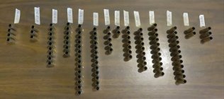

I get a big sheet of paper, a target works well, and weigh and batch them out. Just write the weights you are finding on the paper and cluster together. I’ve found as much as 1-1.5 grains difference between lightest to heaviest, depending on mfr. Those extreme ones become foulers or plinkers. Some brands are tighter in spread than others.
There’s no guarantee that weight difference equals case capacity, but sorting does guarantee a degree of piece of mind. You just have to determine for yourself how wide a weight difference you want to accept. I’m ok with a .2 ish difference or smaller. Trimming and chamfering will remove material, but if the start close, they stay close.

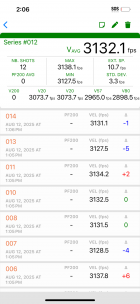

I haven't tested by sorting in that way. I have sorted 100 Lapua cases and taken 5 each of the outliers on each end to see what kind of difference in chrono numbers I get. I did get a significant difference in ES's between the two.
Afterward, I when I loaded the sorted cases I kept them in the order they were sorted. The result was very consistent MV's (very low ES's). The only thing I did in terms of measuring case volume was only an initial sampling to find an average case volume using 10 random case selections.
While there is some correlation for case weight and case volume, it's not a uniform thing. Taking a sample size, like 10 or more, you can see that the more the total case weight, the less the case volume and visa versa. But from one individual case to another, you can have a case that weighs more than another and have more volume instead of less (more weight typically means less volume due to thicker case walls).
I find the best use for weight sorting is to identify the outliers. But I do find having batches of brass that are close in weight, produces very consistent MV's (like in my picture below, those weighing from 172.4 through 172.9 grs did really well).
