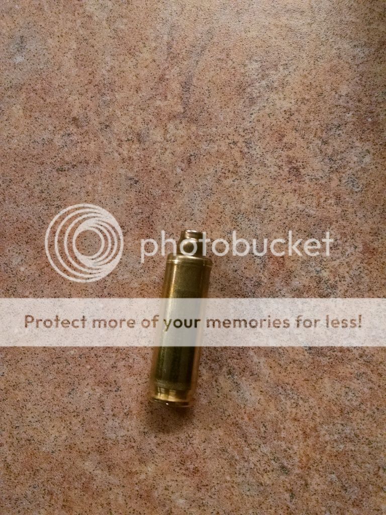

OK..that obviously didn't work..lol..this is what happens when I don't lube cases
Here is what I come up with
Factory brand new lapua 221 fireball case on left, after running brass through forming dies on right. My 17 fireball case w/ crooked case mouth on right. I realize the brass needs to go somewhere when it is neck down.. So do I just trim brass what ever it takes to square up case mouth and should I be turning necks

I think it's a shadow line from factory annealing. As the body, shoulder juncture are nice and square.. After looking at the pic I see what you mean..
In the pic it looks like its buckling right below the shoulder, i think its causing it to get cocked funny. Is the die adjusted down too far maybe? When I size mine, I run them through a cut off 204 fl die and just do the neck, not touching the shoulder. Then through a 17fb fl die and their perfect. Parallel and oal is 1.396.
That's a good point.. Yes it is buckeled.
